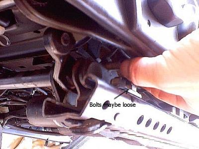

Are the front seat bolts tight? Or the bolts near front motor assy loose they tighten to the seat rails.
