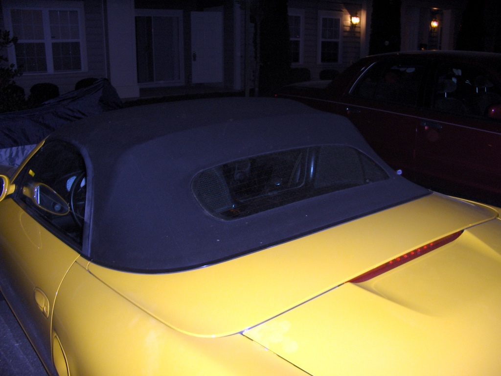

Well, it took all day. And we did have some issues. But it is done. No wrinkles, no fitment issues, no cables going outside the b-pillar trim, no misplaced seams, no leaks (so far!). :)
I have to say, I have done some "difficult" car work in the past. Rebuilt two rotary engines. Clutch replacement on FWD and RWD cars. Starters. Heater cores. Full suspension overhauls. Cut out and welded floorboards. Fuel pumps. Turbocharger installs. None of them compared to the frustration and difficulty of this install. First major issue, the plastic slider clamp pieces were brittle and broken before we even tried to remove them. Buy the clamping pieces ahead of time, and some replacement rivets. They are too cheap to take a chance with... just buy them.
Second problem, the double sided tape absolutely would not stick to the Robbins "European canvas" or whatever they call their "high end" material. We tried de-linting the fabric, cleaning it, nothing worked. The tape would not hold. I used the recommended 3M tape. I guess we did something wrong. Not sure.
Third problem, the front edge of the top was a bear to get lined up properly. The top material wanted to bunch up at the corners and prevent the leading edge of the weatherstrip (with its metal hooks) from seating properly. We had to trim (carefully!) some material to allow it to fit.
Needless to say, it is done, and again it fits brilliantly and looks the dog's bollocks. But I would never ever ever attempt this again. Too frustrating. $800 for labor to install it? Seems very much worth it to me, and I DIYeverything.

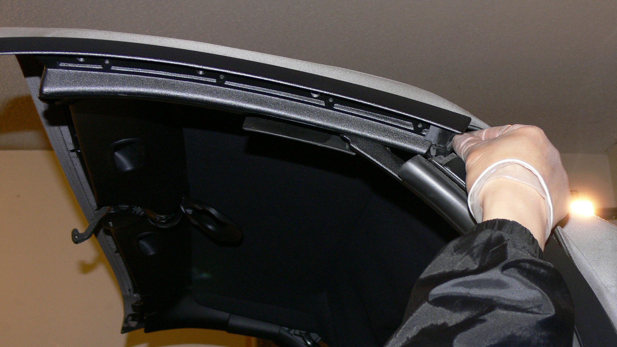

John:
I just took my old top off last night. I'm putting on the new on tonight. I took a picture of a corner piece. Is this the one you are referring to? Not sure if you can see how it is oriented in the photo.
Derek

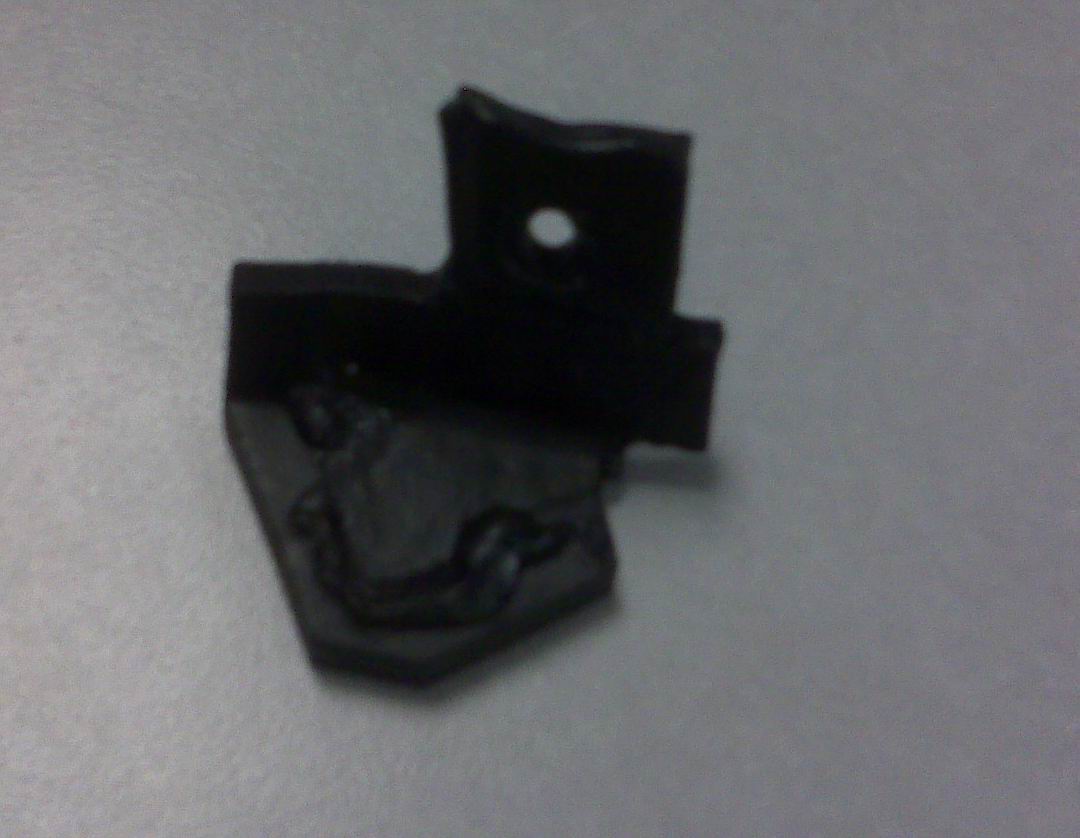

Maurice,
Here is a (bad, blurry, BlackBerry) image of the part in question. Does this "clear" it up? I can't, for the life of me, remember where these came from!
Thanks,
John
Share this post
Thanks,
John
John,
I'm pointing to the little trim piece in the picture I put up on post #6. It goes on after you tighten the aluminum plate, and before you put on the foot long metal retainer for the weather strip.
Hope this helps.
Derek
