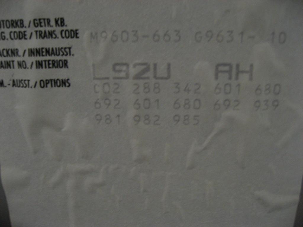

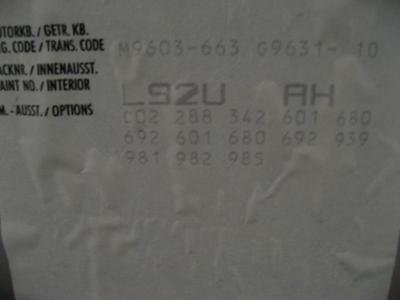

post-29822-1209138731_thumb.jpgAttached is a pic of a VIL from 2003 C4S coupe, 6-speed. In the list of option codes, i could find only 342, 680, 692, 982 in the references.
Does anyone know what the other codes (desides C02) mean? They are 288, 601, 981, 939, 985. A number of the codes (601, 692) are repeating.
From a practical point of view, I'm trying to determine if this car has 18" wheels, bi-xenon headlights and the PSM (which i believe was optional on MY2003?).

288 - Headlight Washer
601 - Litronic Lights
981 - All Leather Lining
939 - Soft Leather Rear
985 - Parts Silver Colored
Try this link http://www.renntech.org/forums/index.php?s...90&hl=codes
Hope this helps.
Will
