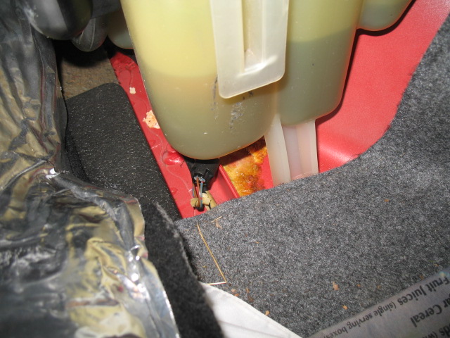

I have a 1999 Boxster that is not leaking any coolant, but it seems as though the coolant reservoir needs topping up quite often. The coolant is not leaking from anywhere either.
Hey Jon, if you're topping off, it's leaking and either/or burning off (can you smell it?), leaking around the pressure relief, bad water pump, and/or leaking in the trunk under carpet, or other. You'd be amazed on how much the trunk can hold. Also, what are the last 2 numbers on your coolant cap? My guess is is 00, you should replace the cap with at least 01
Yep.
I had the exact same problem with my 98 at 75k miles also.
Replaced the cap per first recommendation.
Didn't help.
I was SURE I didn't have a leak.
Pulled out the carpet and fiberboard trunk liner...sure enough....hehe a little puddle of orange...
I did the coolant tank replacement per Tool Pant's past threads on this subject, problem fixed.
Not a walk in the part replacement, not complicated but a pain and takes time (3-5 hours)
if you are not a hard core save $ DIY'er, might want to have it done, if you want to tackle it,
tool pants threads are the bomb!
