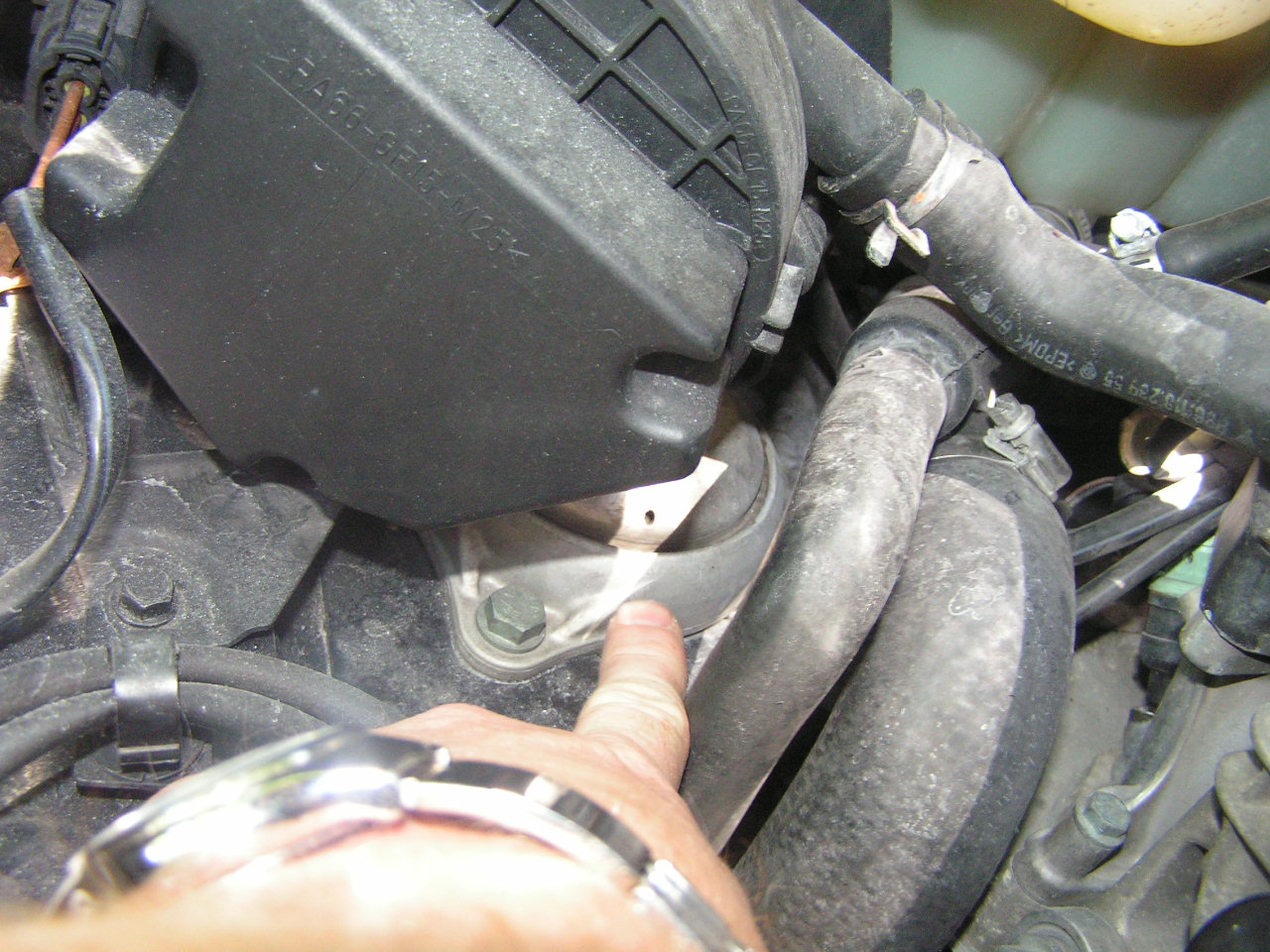

Under the left tail pipe. I had the same thing it turned out to be the factory hose clamp was allowing coolant out. The leak was not visible from the top view. I got under the car and was able to see the spot. I cannot find the pic of it, but I do remember that if you look straight down beside the alternator from the top you will see it( the hoseclamp). You might try and clean that hose etc. up and then drive the car and see if the mess returns. GL
Found a pic it was one of the two hoses you see by my hand it has a clamp close to the alternator.
