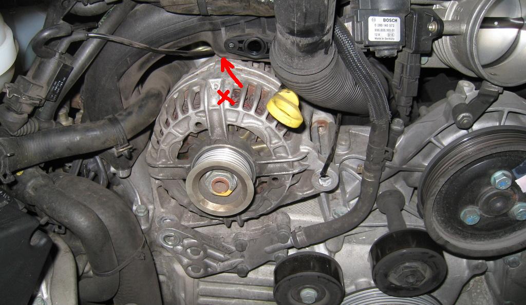

I've got everything disconnected, and all the bolts out of the mounting points, but it's still stuck in the car. The front right mount is now loose, as is the left mount, but I'm having a devil of a time man-handling the thing out. It appears that I can't move it high enough to move it over the mounting points. The intake manifold (at point X on the picture below) stops it from going any higher. Any ideas?
-James.
Well, I got it out. Definitely had a bit of a fight with it though, and unfortunately I broke the coolant connector that runs to the right of it. Still, it's out and the coolant fix should be easy, I hope. Now I have the fun of getting the new one in! THanks for your help.

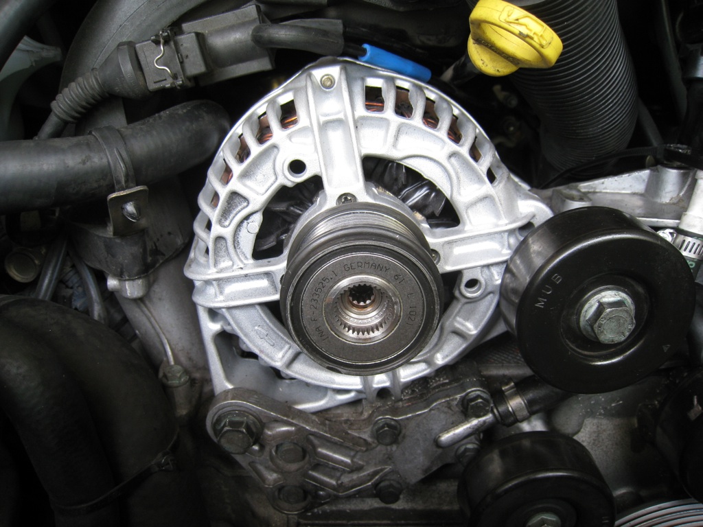

New alternator is now installed. I got it from vertexauto, Izzy, they were great.

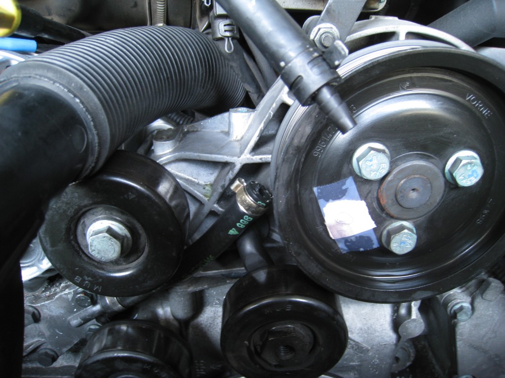

I just have to fix the coolant hose. I have a connector to join the two pieces, but I can't get the old connector on the bottom piece of hose off. I've included a picture of it. WHat's the trick to removing that fastener?
Really appreciate any help - I'm getting there with renntech.org's help!

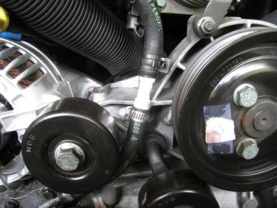

OK, everything is back in and everything seems to be working - we have charging happening, and the other accessories seem to work. However - the car will not idle. This was not a problem before. If I hold the throttle at 1000 rpm all seems good. But it will not idle there by itself. Could I have changed the throttle cable adjustment inadvertently? I'll search around for this problem, but if anyone has any input, I'd appreciate it...
I've included a picture below of the new alternator in place, and the fix on that coolant pipe that I had to do.
