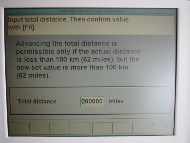

The only thing you might need IPAS codes for would be changing the odometer - but if the odometer is over 52 miles then it can't be changed with a PST2 or PIWIS.
You shouldn't need the IPAS codes for cluster coding. As Loren says, if it is a new cluster you must set the odometer total mileage before it registers 52-is miles. You only need the VIN number in order to do that.
The cluster will be brand new ( :angry: ), so I'll share this info with the shop and see if they are convinced. Thanks for the input from both of you.
