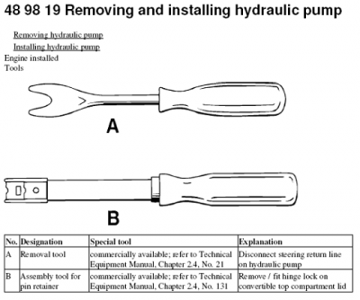

Boxster power steering system (from dry) 1.0 liter.
"Any tips? Looks like it might be a pain"
Yes, it is time consuming. And, the pump comes in several pieces with seals between them.
Attached in Word Doc format are the instructions for R/R. (you may need to remove the
throttle body to get to the back of the pump)

Yup, took about 1 liter. Tips:
If replacing the PS pump, I would use that prying tool. I have a trim tool that's very similar that I use for a lot of prying jobs (like ball linkages), but it did not fit the PS return line well and I hacked the little red connector. Otherwise its not too bad. You might want order a pulley($30) as well. I used the proper puller tool but it was on there so tight that it deformed the pulley. I hammered, filed and sanded down any areas of concern so as not to damage the belt until my pulley arives (the belt costs more than the pulley). If you have not replaced the polyrib belt in a while (several years) its good time to do that as well.(changing the belt requies a 24mm shallow socket and pry bar) Also take the time to clean the throttle body and air intake as it needs to be removed as well.
