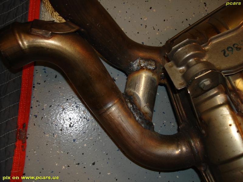

Here is a tip for you.....
You can use your org. muffler and do a simple mod like this and it will only costs you about $400 to have a great sprot engine sound!
I've seen people on the forums that indicate this mod can be done for under $200 by most reputable exhaust shops.
The picture here is mine, from when I had the pictured bypass pipe welded in between the inlet and outlet on my standard 997S exhaust cans.
Cost me $175 to have done and sounds absolutely awesome - hard to discern from the OEM PSE that costs $2000.

DOES ANYONE HAVE ANY SOUND CLIPS YOU CAN POST USING THE EXHAUST MOD SHOWN ABOVE?
I'm curious about the sound versus the PSE.

I just installed a PSE on my car. To me it was worth the extra work to wire it up to an on-off switch so I can make the choice of loud vs quiet. I find I use the switch quite often. But if you don't expect to want the quiet version, the exhaust mod is probably the best bang for the buck, and I understand the sound is very similar to the loud setting of the PSE. Good luck.
Just completed the exhaust mod with 2 inch pipe across the inlet and outlet pipes on 06 C4S. It sounds pretty good, but personally, I think it is a bit loud specially when the top is down, perhaps a smaller diameter would work better.
Here is my question, is there any performance hindrance with this mod?
