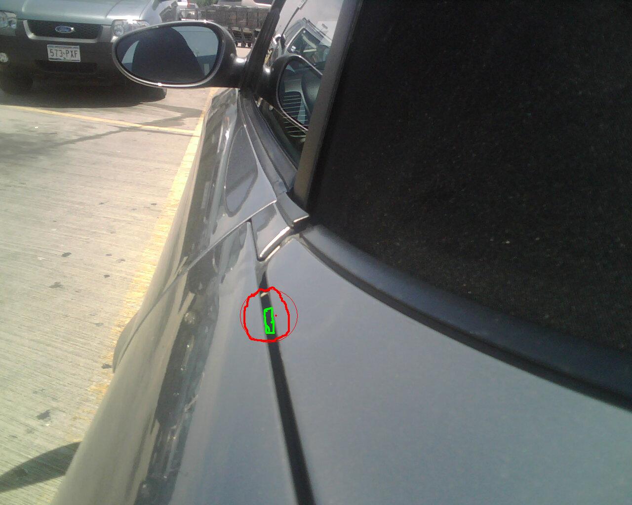

took some pics... not sure exactly what part it is that is the adjustment... want to be sure before i start changing stuff...
where on these is what you're talking about?
Lucky:
Sorry I wasn't clearer. Looking at your photos now, I'm not sure if it's the driver's side or the passenger's side that's off. In any case, this should clear it up:
Here is your first photo with a red circle around the area where the black plastic two-part piece is located. It's below the clamshell, in the rain channel.
I have drawn in green a rough approximation of what it looks like:

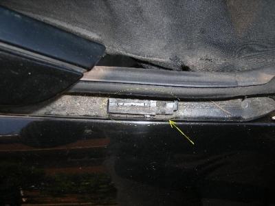

Mine broke off and or are missing. Anyone know part numbers?
silver arrow:
I'm reasonably certain that the part numbers for these parts (Porsche calls them "stops" or "Cabrio Adjustment Plates") are as follows:
986 561 407 02 (left side)
and
986 561 408 02 (right side).
The list price for each part is about $6.85.
Since yours are missing, here is a photo I found that shows you what they look like:
This photo shows the passenger side (right side) one.
