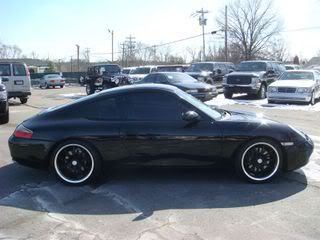

I just bought a 1999 996 today 41,000 miles
And it has a few minor thing done to it, and I have NO owners manual

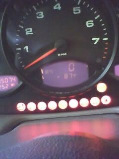

8) where the clock is, when I just turn the key to on (not running). What the small digital gauge?

8. I think you are asking about the oil level measurement at start up. It should be between the min and max bars.

The light comes on when I first turn the key on, I think it the 3rd one over from the left, it goes off when I start the car
Also whats the 1st light on the left, its pointing the rear hatch, it stays on untill the car moves?
