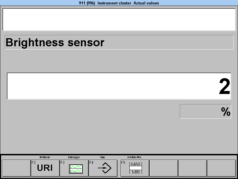

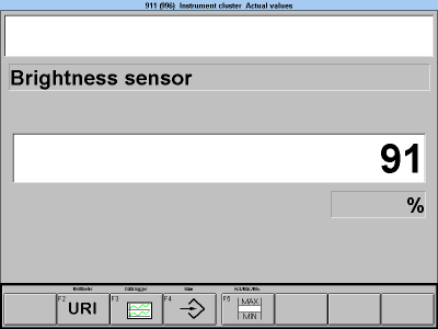

There is a sensor that looks at ambient light to control the cluster brightness.
If you have a PST2, PIWIS, or Durametric software you should be able to test the sensor.

Those shots were taken on my PST2 using the Instrument cluster Actual Values.
If you cover the sensor in the cluster it should change dramatically - likewise if you shine a flashlight at it.
I think I have a cluster problem, but am curious where this sensor is located and can it be replaced?

It can not adjust the sensor, only see if it is working. It either works or does not.
