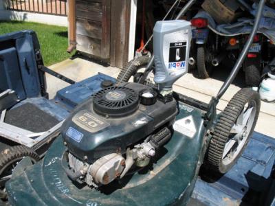

Okay - I've read through as many posts as I can on oil, and seen enough oil fights!
No sense in trying to argue an issue that has too many experts and individual viewpoints. I'll continue using Mobile Water (since the only tangible data point I have is a failed engine within 3k miles after the oil was switched to M1 15W-50).
But I still maintain the following items:
  • lower weight = better cold start protection (related to "w" 1st rating on multi-viscosity oil)
  • higher weight = better race (high-heat, high-rpm) protection (related to 2nd rating in multi-viscosity oil)
  • less of an absolute difference in min/max for multi-viscosity = less additives and less viscosity "breakdown" over time
  • oil change intervals = anything less than 5-7k miles is a waste (after break-in)
  • oil analysis = why not if you have the time, patience, and interest (but you need to collect multiple data points for it to be valid)
The rest is up to us as individuals to decide - as far as I'm concerned, there's some level of rolling the dice. I don't think anyone, including Porsche, has a definitive answer on what's "best."
