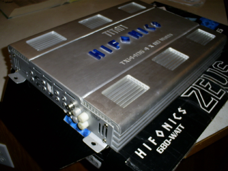

Hey All!!
Just got my stereo-system together....well almost finished......after three wednesday-nights of hard work :)
After starting with reading the great guide from AndyM and great help and hints also from Juniinc and others in different threads on this forum I created my own ideas. And my conclusion is: Skip the Rear-system in the first place......start with the amp, door and dash-speakers instead!!
I recently bought a -99 with ONLY the dash-speakers as stock (called option 441 I think), bought it late June and my first thought was: " - I Have To Do Something About The Sound System!!".......and then I read all the threads on this forum :)
So here´s what I did:
1. I ordered the rear-system from Harvey and installed it. Great Guy with great service, providing a great "how to" - guide and great fit.
2. I got hold of ISO-cables for the stereo, one to get two Line-Out signals for the amp(s), and one to activate the AUX-function, so that I can play my Ipod or other sources.
3. I connected a Flat, active Subwoofer to one of my Line Outs and hid it in front, under the floor mat on the passenger side. Also had the AUX-cable end up in the storage between the seats, so that I can hide my Ipod in there!
4. I hooked a four channel-amp up to my second line-out. Mounted in the front trunk behind the spare tire. I connected a set of 5,25" MB Quart to two of these channels and mounted them in the doors ( a system with Woofer/tweeter).
This was what I did yesterday evening and boy.....that was a tough job!!!
All the guides I have seen concerns upgrading already existing speakers in the doors, but have You guys tried to get new speaker cables in there?????? TIGHT!!!
But HEY, finally I´ve got great sound.....very Happy today!!
Next step is to change the dash-speakers as well and hook them up to the remaing two channels of the amp in the front.
Or maybe I could improve the sound just by running the stock-speakers with that amp??
Opinions??
Well, my reflections after doing these changes are:
Start with the "front stage" - sound, if You have the 490 option I guess You could just upgrade the speakers You´ve got and add a sub. And if You´ve (like me) got the 441 option: Get a great pair of speakers in the doors, and get a great amp to run them......also add a sub!
As for the rear-speakers: Maybe I went the wrong way by STARTING with these.........I guess that maybe if I ride with the top down at high speed they could help a bit.........but 3,5:s dont produce a good sound......and I think I wanna hear my music from the front......but hey, that´s just me :P
MAYBE also, If i Run the rears on an amp they will make more sense??
Still, all credit to Harvey at PNP, Great Service!!
Ok, That´s some opinions from Sweden, Guys!
Thanx!
//Mats
