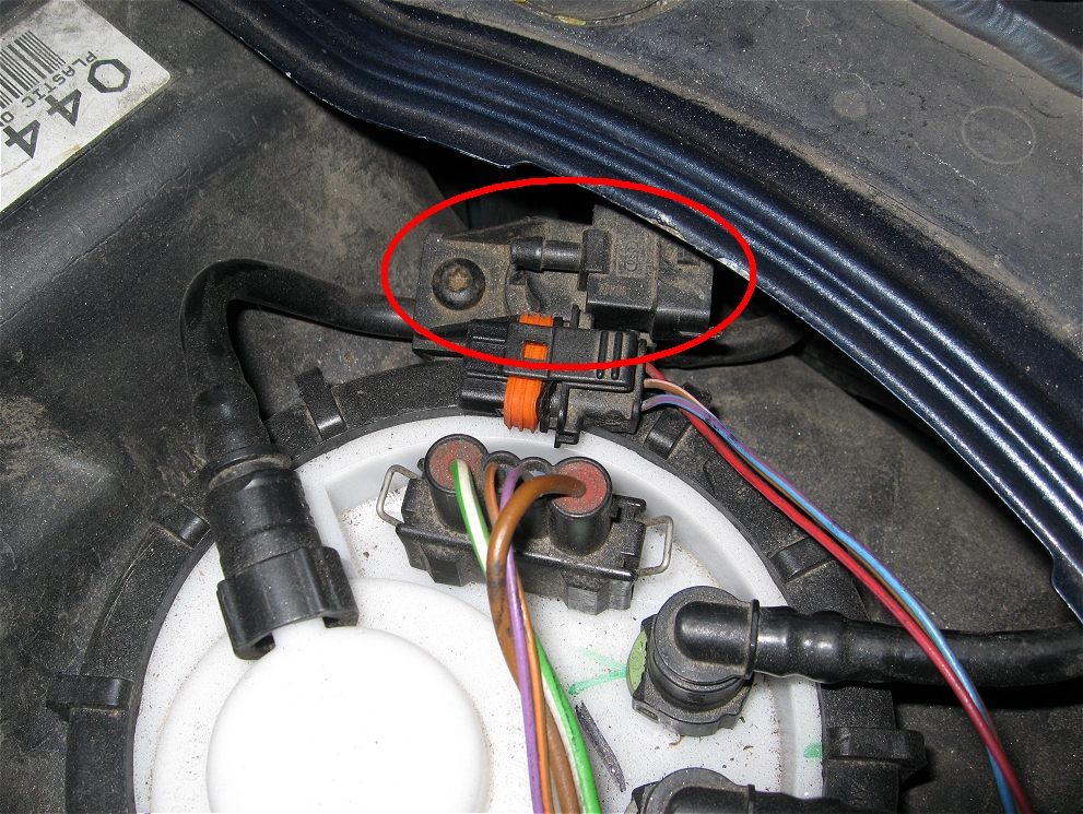

Stefan's pic
What happens for this system to work is the EVAP canister's shut off valve is closed and the purge valve is opened. This in turn allows vacuum to build up in the system and is measured by the pressure sensor. When a specified vacuum is reached the purge valve is closed. Now the pressure sensor measures the given vacuum over a set time. Should there be a leak the vacuum will drop accordingly. When the shut off valve is faulty no vacuum is built up at all. The purge valve when faulty allows the vacuum to be built up , however it doesn't close so the sensor never has that constant base reading to start by(PCA)

Stefan's pic
