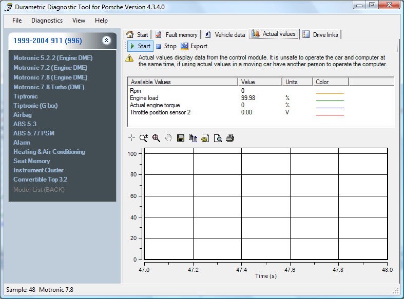

Can the Durametrick grab past values from the car? (without being hooked in real time?)
I have a hunch that My K&N intake works great on the street but is actually hurting the car at the track because it's not sheilded well enough from the engine bay. I'm trying to get a picture of the air intake temps while I'm lapping on the track to confirm this...and since all of the sanctioning bodies force you to make sure the car is absolutely empty or everything safely secured I'm guessing they won't like the idea of me having my laptop in the car flying all over the place.
I was hoping I could isolate which value it is on the AC Diagnostics so that I could give it a quick glance during my laps. It's easy enough that I could throw back in the stock airbox between sessions to compare.

Can the Durametric grab past values from the car? (without being hooked in real time?)
No, no tool can do that since they are not stored. Durametric, PST2 and PIWIS can graph trends of real time data (while connected).
Back to the drawing board then. If anyone can confirm that 35c or 36c are air intake temps I'd really appreciate it. Going to the track next friday equipped with my K&N and stock airbox to try to do some real world testing of intake temps during track driving.
