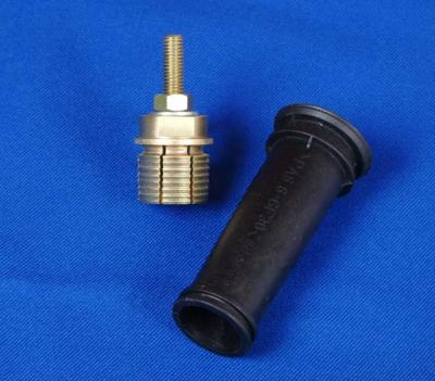

Porsche has a factory tool. I have never seen it because all the mechanics I know simply pry out the tube with a small prybar on the edge of the tube. Pic is an aftermarket version, but if I remember correctly it is like $100.
If you cannot pull them all out with your finger and don't want to pry them out, then you need something to shove inside the tube that you can expand inside the tube to grip the tube. Then you pull on the end of this something to pull the tube out. People have used a spark plug boot puller. Shove the puller inside the tube and expand it so it grips the inside of the tube. Then pull the tube out.
