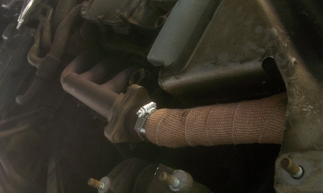

Here is a photo (that was posted by Boxsterra) of what the heat wrap looks like:

There are two heat shields on each side and all of them have a tendency to rattle. The ones in the picture (front) are very difficult to fix as they are originally spot welded and the weld breaks over time. I ripped them off and replaced them with heat wrap.
The rear heat shields cover the cats (secondary cats on your car, only cats on my 1999). Those can be fixed by replacing the bolts that hold the shields on.
The easiest way I have found to locate these rattles is to get under the car with a rubber mallet and pound the exhaust until you hear a rattle. Then touch each of the heat shields until the rattle stops and you've found your problem. Of course this should all be done with a cold car. (The cats get super hot)
