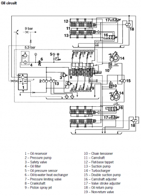

Thanks, yes that makes sense, but do you know if the turbos are oiled by the engine oil, or are they on a system of their own that requires oil to be
added in a seperate location?

Yes, it is engine oil fed through pipes.
Here is the 996TT Oil Circuit (item 14 is the turbos)
