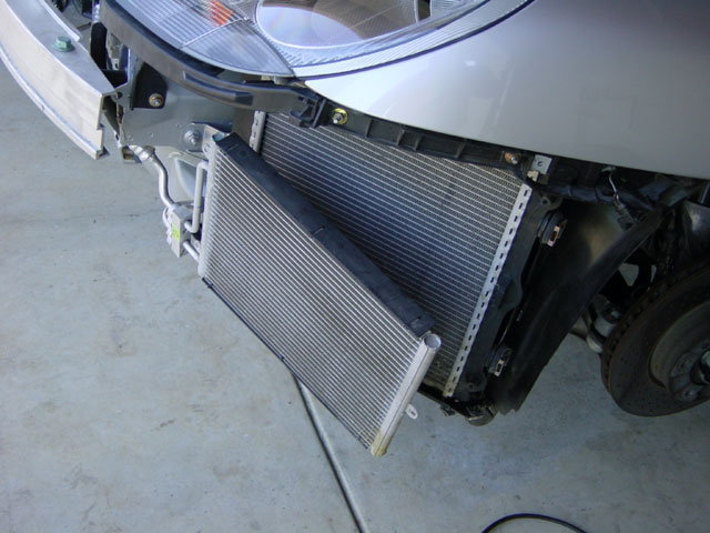

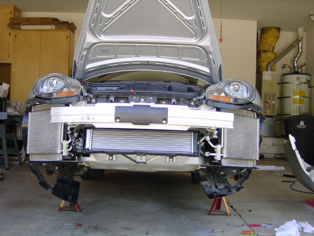

How many radiators does an C2 have?  two or three?
One radiator in front of each front wheel (2). There is also an A/C condenser in front of each radiator. Exceptions with three are: Tiptronic cars, X51 cars, GT3, and cars like mine that have the third radiator added on.
Third radiator (only on some cars)
