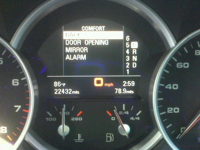

UPDATE - FINAL (I hope)
I took the Cayenne S to the good people at STAHL MOTORSPORTS here in town. They were highly recommended and I can see why. Many nice Porsches there. Initially there was not much luck reprogramming my new cluster. Upon contacting some other Porsche techs in the UK, Stahl uploaded my CS programming info and the techs in the UK processed that and sent a new program to Stahl which they transfered to my CS/new cluster. BINGO error message removed for Air Suspension- ALSO error for TPS GONE as well. Finally- I have seen in previous posts a problem with graphics on the comfort screen- NO such problem with my CS- all lined up properly. All functions of the on-board computer work as previously
(locks, lights, clock etc) ALSO the same graphics from the radio AND the Navi still appear on the new cluster screen but alas in full color. Speedo working as well along with trip odometer and transmission indicator.
In summation- the mileage odometer still retains the mileage on the actual cluster ( This can be fixed) AND the BAR guage is NON functional. Pix slightly blurry from my phone PM for better pix if you like.
Thanks to all who have watched and posted info here especially Loren. I hope my experience helps others- I welcome any PM's to enthusiasts attempting same project. THANKS!!
