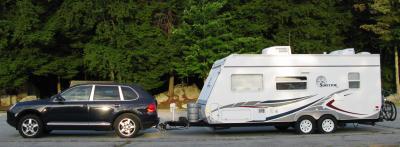

Based on my trailer experience, I use propane during traveling and it's much better than electric. Even for long ride from Montreal to Florida (25hrs driving time) On my previous car (not the cayenne) I burned two alternator in 2 years when I used electric fridge with another electric cooler in the trunk. I suggest also to check your deep cylcle battery beacause a dead one can take an extra electric load on your car. Have a nice trip to america.
