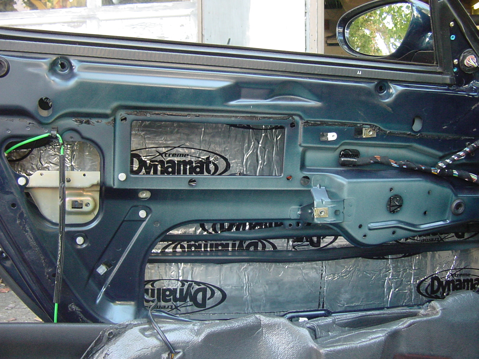

There is enough access to easily do it with three horizontal pieces, one above the other.
Here is a photo of what it would look like:
Note that this is on my Boxster, but I believe it's similar enough (or the same exact door) as a 911.
Piecing it together to get full coverage is just fine. Cleaning the surface with denatured alcohol or similar solvent will insure you get excellent adhesion.
The access to the inside is different on 997/987 they use the same system as the Cayenne. You have to remove the trim, than you have to remove the inner part of the door ( panel with the door lock and handle assy, window, window regulator, etc. ) The door is made of two pieces, inner and outer part. Take a look in PET to have a idea.
Thanks for the suggestion and the picture ( always worth 1000 words ). When the weather improves, or I heat the garage - which ever comes first, I'll give it try. Having looked at the PET as RFM suggests, and POSES, it looks to be a little more of a challenge than I expected but do able none the less. At this point it's simply a matter of time and motivation. Maybe closing it more gently isn't such a bad idea after all.
