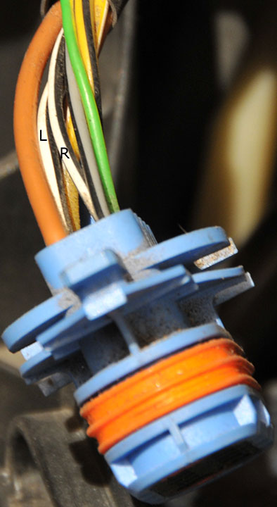

So guys I'm getting ready to do the 'blinking side markers' mod. I got the headlights out and as per member itzkirb I'm supposed to pick the BLACK wire with WHITE stripe (I'm on the driver's side). Of course nothing is that easy! There are 2 wires next to each other that have black and white so I'm having a hard time picking the right one, I think it's the one marked R, but before I go cutting wires I thought I'd ask for an expert opinion. Kindly see pic below and let me know:
Note, IMPORTANT: On the left side, the BLACK/WHITE wire is SMALLER in diameter (thinner) than the WHITE/BLACK (white with black stripe) wire seen at the same connector. The thicker wire is used for high beam circuitry. To verify you have the correct wire, the BLACK/WHITE wire is at pin #7 of the connector. Also, note that PAG grey appears to be almost the same color as PAG white. Do not confuse the two colors.
