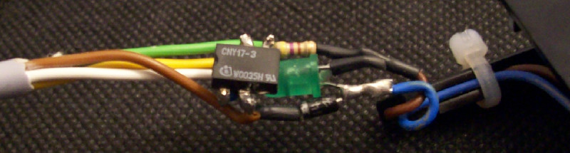

OK, since I'm gonna be experimenting with the spoiler anyway I just had to order one of these lights.
So it arrived today and when I opened it I immediately noticed the rectangular lump under the hear shrink.
I was hoping it was a microcontroller. Then I looked at the instructions and the wiring diagram.
I saw that one of the wires goes to the speed gong setting pin. So it has to be a microcontroller!
Nope, when I looked closer, the obc speed gong setting wire and the spoiler extended limit switch wires
are the same color and on the same plug.
So, me being me, I cut the thing open to see what makes it tick. I drew out a diagram. Nothing special.
The dip is just an octocoupler. A couple resistors, a few diodes, and a flashing led. No joy.
You'd think for the price the guy could've at least used a little piece of perfboard. :rolleyes:
