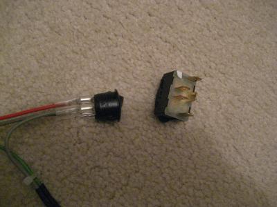

I picked up the footwell switch from SunCoast. They said they think the light is LED. Below are the two switches. There are two leads on the original and five on the Porsche switch. Which ones do I use on the new one? Did I mention I'm an electronics idiot?

On the Porsche switch the far outside two pins our for lighting the switch when the head lights are on. So us will be using the three pins toward the center. Get a cheap Ohm meter and check the function of the orignal switch and compair it to the porsche. ie. check the red to gray wire pins, gray to gray, and red to the other gray. Do this with the switch in the on and off position.
You might even get someone aradio shack to help you do this.

I'm not quite sure how you're wanting to wire it, but if you're trying
to use the footwell switch as an on off switch, it won't work. At least not by itself.
The switch is momentary. The circuit that it normally connects to does the latching.
Also note that with LEDs polarity matters. So 3 and 5 must be ground if you want them to light up.
Which means 4 would need to be +V.
I've designed a circuit that gets around all that, lights up the LEDs, and lets you use the footwell switch for
whatever function you want (even multiple functions). I haven't made one that latches yet, but it wouldn't be hard.
You're friend should be able to fix you up. Just show him the diagram.
