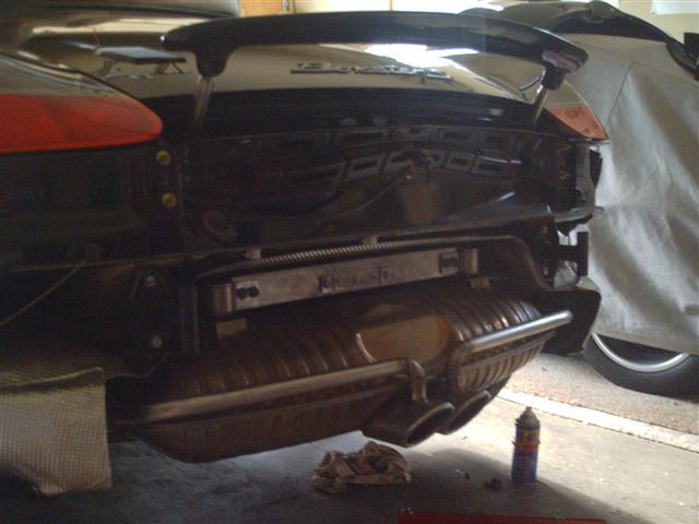

Hey Drem!
Put the Boxster in a gear somewhat too low to pull a steep hill and accelerate up that hill.
The mod seen above is EXACTLY what Porsche did with their "Technique" sold mufflers. They re-route raw exhaust to the tips :)
Easy and cheap to do! Porsche put an electronic control on it.

Following up on my prior post, the Oettle modified muffler with the bypass pipes does not drone or resonate, as it is a factory muffler. I also have Fabspeed bypass pipes eliminating the secondary cats and the sound is superb.
This mod is very simple to do if you have welding skills or can pay someone to do it for you; cost of materials is negligible.
Do you have a link to the Oettle mod? I've heard good things about the Dansk but they don't make a sausage for the early 986 2.5's anymore. Anyone tried the Maxflow small mufflers as a replacement?
Go to pedrosgarage.com. It will be in English, not German. Don't think the Germans give DIY.
