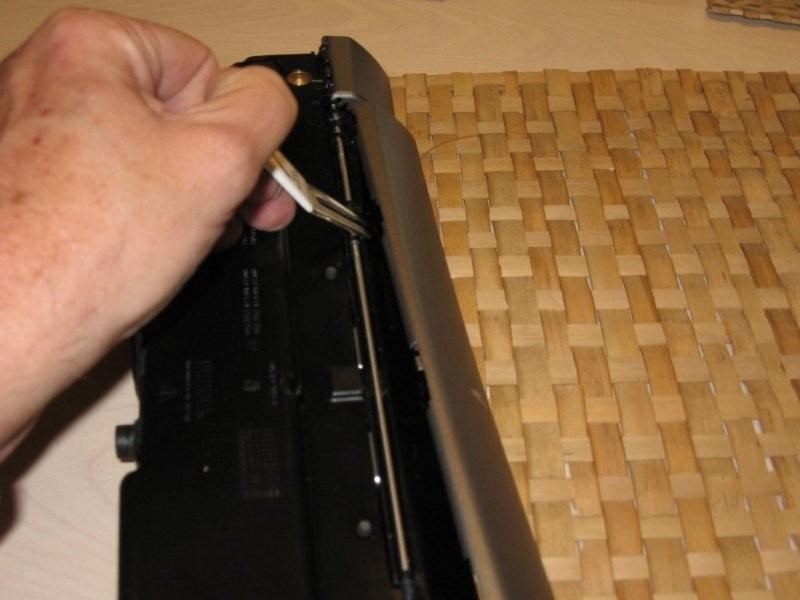

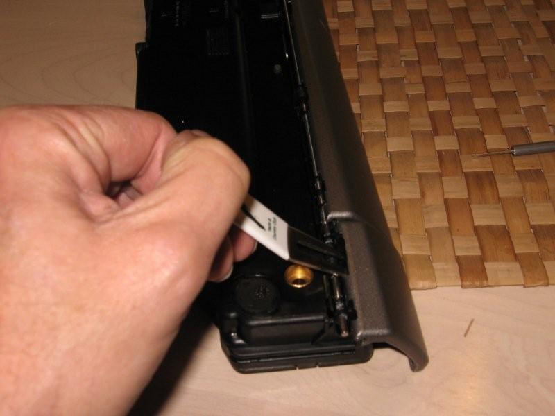

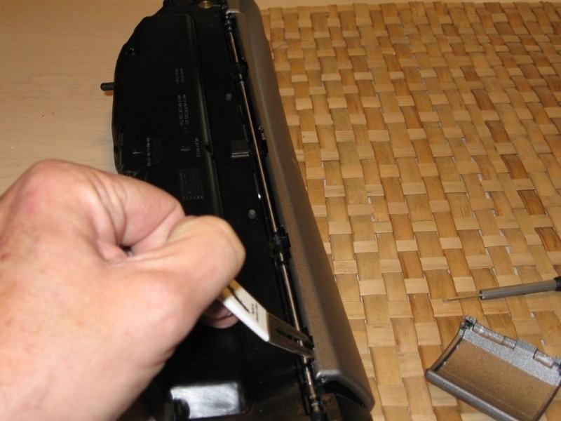

OK guys, here is the solution thanks to Joe Desimone from Planet Porsche...the silver painted trim pieces on the cup holder are only clipped onto a black plastic substrate. This is not evident when looking at them. They can be removed by carefully prying them off with a plastic wedge, small screwdriver or trim removal tool. First remove the tray from the car. Then working from the HINGE side, carefully pry the pieces up from the bottom. I have included some pics.

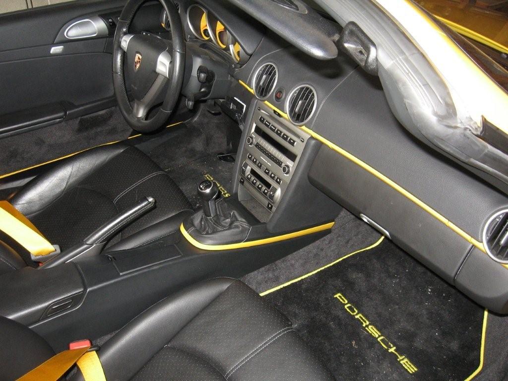

Just a final note: I had parts painted by Eric at Bumperplugs and they did a great job! Pix of painted trim:
