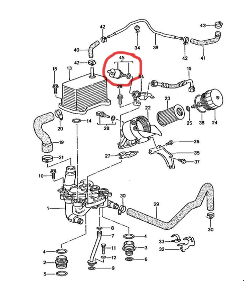

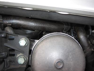

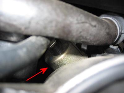

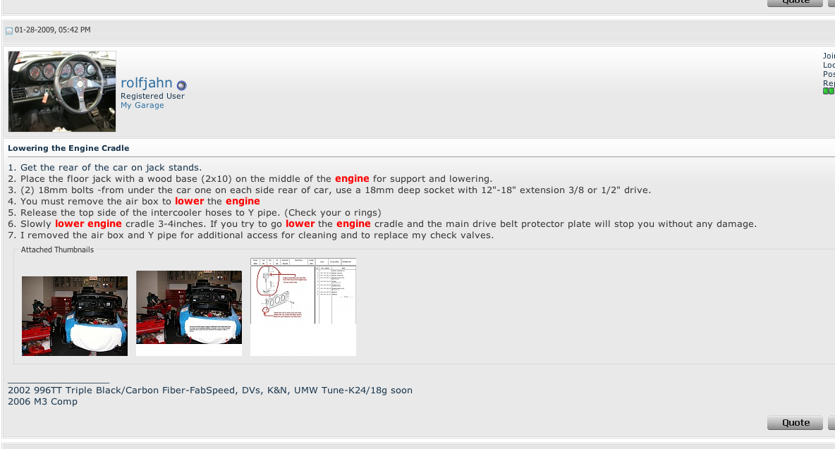

The oil pressure switch is something that seems to fail often. It is only about $60.00 part# 996 606 203 00. The location is behind the oil filter and it is not easy to reach but can be done. To get more access you can always lower the engine about 2 to 4 inches see note below....
