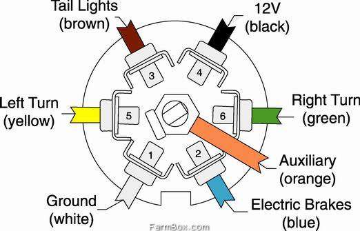

If you want to take your voltage on the trailer plug, hope this diagram can help you. On most trailer the black is the positive and white negative.
