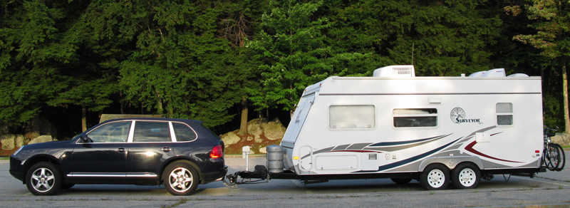

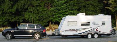

I was surprised like you at the first reading, but after reading again the TSB... Saying 308lbs without changing vehicule ground clearance and the max is 616 lbs. I use spring bar with my 23' travel trailer and the road handling is wonderfull. The tongue weight w/o spring bar are around 600 lbs. You can look at this picture and the car loose about 1" ground clearance.
