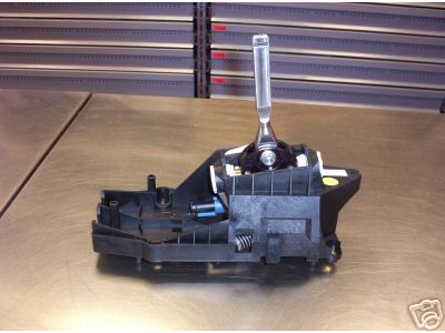

Picked up a new Porsche OEM short shifter today on ebay, sold by Braman Motorsports (a Porsche dealer in West Palm Beach), for $300. It comes with the housing, unlike the B&M, and for this little extra I thought it was worth sticking with OEM and that the housing may make for an easier install (not that the B&M install seems difficult). Pic below. Braman says they will continue to list on ebay and might give better deals than their normal $350 price if you asked. [Javier in parts, 561-615-4877; no affiliation with them]
I have searched here and rennlist (though probably not thoroughly enough) and haven't found any DIY instructions specific to the Porsche SSK with the housing. Does anyone know where I can find them? I also saw a recent thread that said there is a special Porsche tool to check the shifter adjustments (the poster had to replace his B&M shifter with the factory before the dealer would check his transmission) - wondering whether this means its better to spend $100 or so to have the dealer install it correctly?
