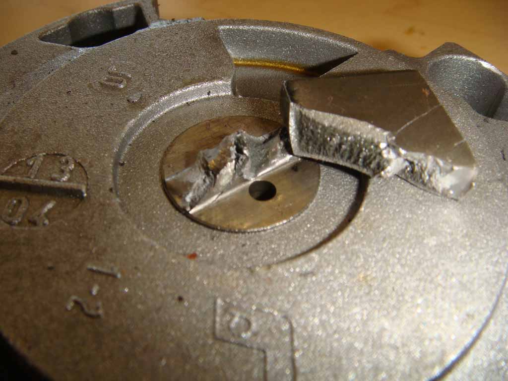

Here's a summary of the problem from the dealer (2005 997 C2, 70k miles, 3.5 months out of warranty):
As I mentioned on the phone, during our road test we’ve discovered the engine had a major oil leak from the valve cover. We then lifted the vehicle and found a hole in the valve cover. (I took pictures and put a quarter to relate the size of the hole) We then removed the engine from the vehicle to further diagnose the problem. We have discovered the oil scavenging pump for bank 1 has seized. The pump has a drive that goes into a notch on the end of the camshaft. The drive and notch have broken into pieces from the pump seizing. There is also damage to the timing chain and chain guides. To repair, we would need to replace the cylinder head due to the cam bores/bearings are machined and center cut to match. We would need to split the engine case to replace the damaged timing chain. The total parts for this repair alone cost $5500.00 and the 30 hours of labor is $4950.00, making the total estimate $10,450.00.
Anyone else ever see such a failure on their 997-1?
Yes i have seen this before on 996, mostly with damaged timing chains as result, which blows a hole in the valve cover. Is the engine still the original one? If yes, i would insist to give a factory rebuild engine in warranty since the car is a famous MY 2005, a problem would be the milage but i would go for it anyway. The best of luck.
With those cost figures you are bascally at the cost of a remanufatured engine, although you might not get the core deposit (at least al of it) back. And with the reman engine you get alot more new parts, etc. and a warranty. Kind of surprised that the dealer has not suggested this.

I was equally surprised that the dealer didn't mention the remanufactured engine. I finally figured this out on my own through a lot of questions about warranty. We'll see what the cost of the remanufactured engine will be - I learn tomorrow.
