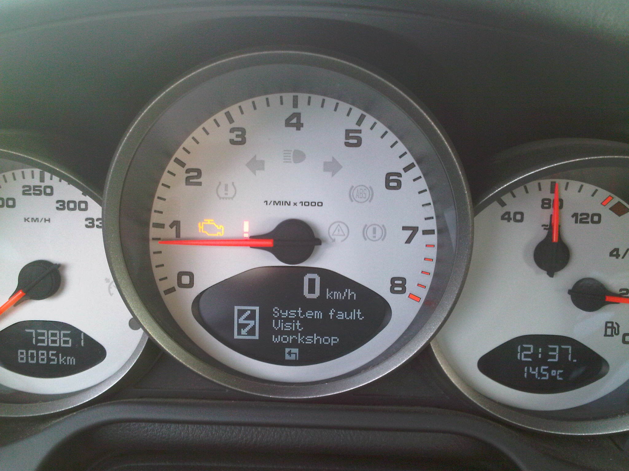

Just suffered the same fault on my C4S. Replaced plugs & coil packs, missfire persisted. Checked & cleaned air flow meter, no improvement. Took into OPC who first checked vario cam sensors - no fault found. They then went through a process of swapping parts from a donor car and eventually traced the fault to a faulty valve lifter solenoid. Parts weren't much but 4 hours labour at OPC doesn't come cheap.

- My engine blew up in sept 2009 on the track (MY05 IMS) and porsche provided me with a MY06 engine free of charge, cost me $6k in labour to replace etc, and got a 2 year full warranty on engine (link to complete story here)
- Two weeks after I got the car back (4 weeks later), my check engine light came on. So back to OPC I went, car was looked at, they told me it is a cylinder misfire, and it is normal for new enginers and that I should keep driving the car under 4k rpm as I have had for the prior couple of week. They reset the light and gave the car back to me
- few weeks later, light comes back on, I can paste the last point 6 more times for you guys with reasons varying from: - oil cap was on wrong (nobody had touched the oil cap but the OPC), more misfires, may be your flywheel slipping or being misaligned, could be your crank shaft being misaligned, could be your coils/plugs, your ECU/computer needs to be reprogrammed
- so far I have swapped all coils/plugs, reprogrammed the computer, and also I have a brand new clutch as well as flywheel put in the car which was not cheap and the misfires persist
The car drives beautifully and no mechanical or performance issues are present what-so-ever. I read in the last post regarding "faulty valve lifter solenoid" ? should I bring this up with the OPC? is it normal to take the OPC over a year and with so much additional costs to me? Where is my warranty? this issue did not exist prior to engine swap. The issue happens for me in one bank only and the fuel compensation to that bank is slightly different than the other. I could provide more PIWIS info if required.
