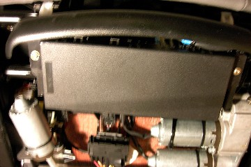

Is this what it looks like?
If so then you can disconnect the harness from the control module underneath the seat.
This is from memory so some of the details may be off
First remove the front plastic bumper shaped piece. It slips on and is retained by two platics nubs that sit in holes in the metal bracket that is a part of the metal seat frame.
Then undo the two brass colored torx screws that hold the module to the seat.
There are two connectors that need to be disconnected.
The first is a regular plastic 4-8 pin ( I do not remember exactly how many pins) one that comes out easily. The second is a 20 pin or so PC board type connector. I seem to remember there being a plastic U-shaped locking piece on this one but I could be wrong. This one pulls up from the module and is quite tight.
If you need more details let me know.

Yes, under the seat it does look like that. I've seen many pics of turbos etc with the GT3 seats put in so I assume there has to be a way to remove the stock seat (and associated black box) leaving the "535" box controlling the alarm, central locking, etc intact.
Unfortunately seeing under the seat while in the car is a little bit of a pain in the ***. I'll take a look again this weekend (the stock seats are back in the car), and see "what's up". (no pun intended)

You were right, but I did not have to take off the small plastic "bumper" though...just lifted the front of the seat, took out the 2 torx screws on the seat control module, and flipped it upside down to remove the 2 cables with the "computer" and 6-pin connectors.
The ONLY problem I had was that the seat belt anchor on the driver's side Brey-Krause bracket, was not machined/tapped quite correctly, and stripped the seat-belt mounting bolt (no I didn't cross thread it!), but luckily I had spare bolts and a dremel and corrected the problem.
