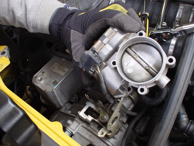

This is what I am talking about when I say throttle body.

The there's no oil on the outside, and none that I can see around the valve opening area. The picture I took was opening the valve trying to look inside, except I can't tell if it is oil or just carbon build up. I was hoping that you can tell from the picture.
Am I supposed to completely remove the throttle body from the car to look at it from the part where it attached to the engine?
If the AOS is bad, is it supposed to be an obvious amount of oil? Does the oil get on the valve and where it connects with the rubber housing? I didn't see any there, and didn't feel any oil as far as my finger can reach into the throttle body valve opening.

Okay, sorry I understand your picture now - it looks clean.
Likely a bad MAF at this point.
If you have the Durametric software (or a PST2 or PIWIS tester) you can read the MAF and see if the readings are at spec at idle and 2500 RPM.
Only way to be 100% sure it's the MAF.
