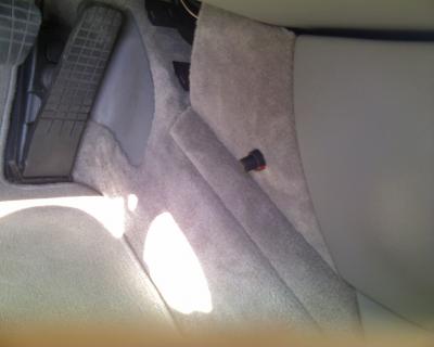

So I've had a 2004 C4S for a couple of years, and I've always wondered about a mod done by the previous owner. I was hoping the collective expertise here at RennTech might be able to shed some light on it.
There is a small switch of some kind on the carpeted side of the upper center console by the driver's right knee (two pictures attached). The switch is wired to a tiny speaker hidden in the A pillar trim to the left of the driver's head (pulled down from the trim in the attached picture). There are two moving parts on the switch. The center knob controls the volume on the speaker. The outer ring is a dial that rotates one click in either direction from center. If the outer ring is rotated in either direction, the speaker makes a sound like a radar detector turning on, and then beeps once every five seconds. There is no obvious difference between the clockwise and counterclockwise settings. When the outer ring is clicked to the center, the speaker is silent, and whatever it is appears to be off.
Other than these two things I don't have any visual evidence (for example, I can't find a detector hidden anywhere). Any ideas? Eventually I will get curious enough to tear everything apart and follow the wires, but I was hoping for suggestions first. Sorry for the poor cellphone picture quality. Thank you in advance for any thoughts.
Trevor
I had a similiar switch on my car when I purchased it and found out that it was indeed for a radar detector. Can't remember the brand of the top of my head, but if you turn the knob in either direction from the center position it switches the radar from street driving to highway driving. When the switch is in the middle then the radar is turned off. The difference between highway driving and street driving, is that on the street you get more intereference on the radar and it signals more frequently, therefore you want to make sure that you put the radar in street mode when driving on the streets, so you don't get the annoying noise all of the time. My radar transceiver unit was mounted inside my front bumper, so you might want to check there.
it is from a K40 undetectable model. usually has front and rear sensors
do you have a front tag frame? if so does any wires go to it or can you see a small box in the front grill?
should have a small box mounted in the rear bumper area also
