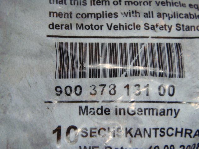

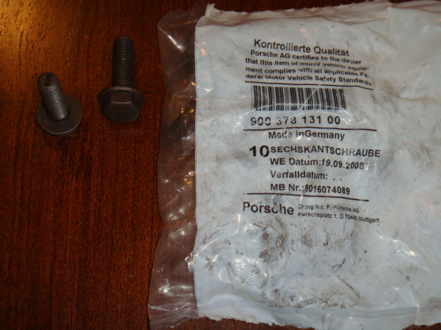

here is the part number for the porsche bolts from EBS Racing: it is 900 378 131 00. I'm going to start buying parts from these guys. It's way cheaper than going to my dealership for parts..and it's free shipping since they have a local shop in town...
also, you need to phone in the order. It won't show on their website. Here is their contact info :EBS Racing inc. | 4068 South McCarran Blvd. Unit B | Reno, Nevada 89502
Phone: 775-673-1300 | Toll Free: 1-800-462-3774 | Fax: 775-673-2088. It's $2.00 per bolt, I think it's worth it especially if yours is like mine which is all rusted and broken. Again, their website is http://www.ebsracing.com. Ask for Don.
