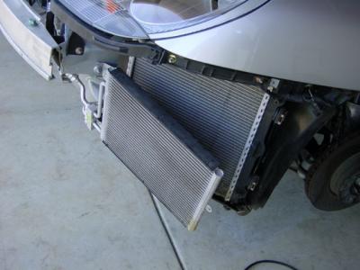

Just to give you some idea of the kind of crap that accumulates, here are a few pictures from a 1999 Boxster. It did not appear the radiators had ever been cleaned out.
Here are a couple from my clean out event on my 04 C4S
After:
I just did this last week with a shop vac. I couldn't believe how many leaves were in there. Your pictures look exactly like mine did. I really don't notice a difference in running temps though
