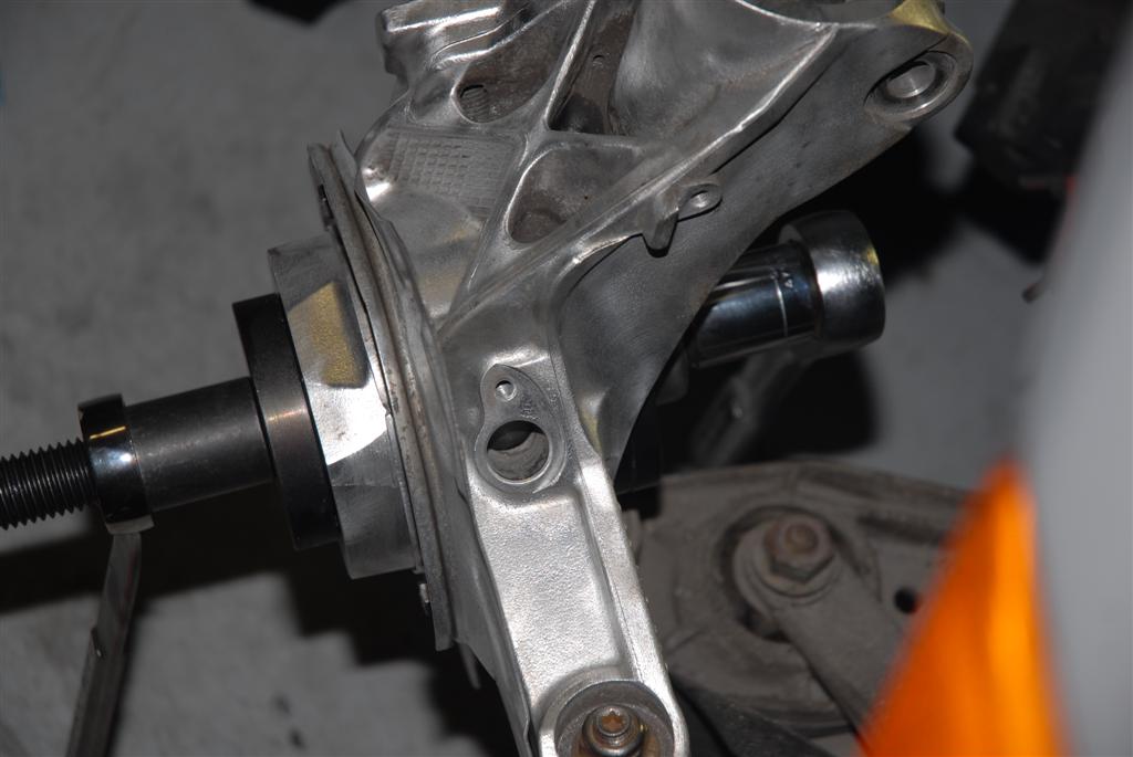

While trying to remove a speed/abs sensor in my '97 Boxster it broke in half as it had become well and truely stuck in the hole. Surprising as the sensor is plastic cased... I have subsequently been trying to dig/drill it out but have gotten nowhere.
Anyway, I am now planning on removing the wheel hub and dismantling so I can hopefully knock it through the hole it is in.
Can anyone confirm that if I remove the tension bolt (5) I will be able to do this, i.e. that the hole isn't blind? I assume the reason the tension bolt has a toothed circumference is that this alters current produced by the magnet in the sensor and so provides a signal to the ABS unit?

Yep you should be OK. This pic should help. What you see through the hole is the tool i was using to remove the wheel bearing.

Yes, it is a through hole. Not sure how the sensor works, but if you get the wheel carrier off, and the front short axle out, you will see it. Very tight quarters in there, though.
