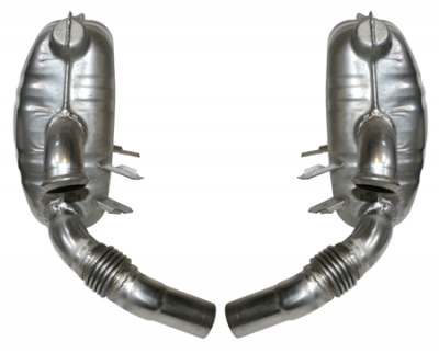

these are the mufflers available from the site.
Exhaust Muffler / Silencer Sport Super Sound Porsche 996
Code: 99622010123
DesignTek Sports SUPER SOUND exhaust made from High Grade stainless steel. Price: €802.40
or
Exhaust Muffler / Silencer Sport OE Style. Porsche 996
Code: 99622096330S
Replacement Rear sport exhaust set OE style. Polished stainless steel. With TUV/EEC approval.
Made by DANSK Price: €772.06
Thanks in advance.

I'm more now thinking a new muffler is the way to go & not a 2nd-hand one with unknown potential problems?
I just have to now get it next day delivery form the UK to Ireland in time, I leave in 6 days on vacation.
How long does it take to install the a new muffler system on the 996?
Many thanks.

IF the specs are okay, like Loren said, I say go for the new muffler. If you go to all the work on the old muffler from the junkyard you will probably will switch it out sooner than later. Install on a new muffler is not a terrible job and can be done in 1-3 hours. Just make sure that you get all the fasteners the hook up the old muffler to the catalytic converter. They do make some quick snap on type fasteners that may make the job easier. Also try to get a buddy to help you hold the muffler while puttting in place, they helps a lot. I am sure there is a DIY on the RennTech forum that will help too.

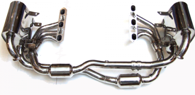

BIG change of plan, on Thursday I made the order of not just the muffler's but the whole exhaust system.
After all I got them in time :rolleyes: Orient Express your comment scared me :D
Sports Exhaust Package (+18 to 27 bhp) Porsche 996 C2 / C4
Code: EXHAUSTKIT96
Sports Exhaust + Headers + 200 Cell Sports Cats Package (+20 to 27bhp)
DesignTek 996 Stage 1 Performance package. High Grade stainless steel exhaust system for Porsche 996 1998-2004. 14 - 16 gauge T304 stainless steel.
Includes sports mufflers, Equal length headers, 200 cell sports cats and fitting kit, giving +18 to +27 bhp that you can really feel and superb sports car sound.€2,106.30
The sound! on start up it's not as aggressive as my old OE exhaust? it's deep on idle, it's in the mid range it's more noticeable
it's a sharp grunt more high pitch! You cant definitely feel the power increase, also the car feel's more solid on idle,
(Odd to say this but it's like it has a new set of lungs & is breathing more freely) Also it's strange but the whole system is like half the size of the old, it's pretty small??? the cat's are half in size & muffler's a 3rd the size of the OE one's...

Wow, that's a major change!
Do let make the video clips for us. I have been considering this system too.
Are the Mufflers themselves, light weight or heavy, solid and dense? Did all the bits look exactly as pictured, or different? Sometimes internet retailers may use a picture that varies from the actual product.
We look forward to more review on the system. Enjoy!
996noob,
The muffler's are very light & dense (you can lift w/one hand) & look's exactly like it does in the picture with a cool DK logo on the each cat.

Well 3 hour's of the boat in France my new exhaust blowed out on me I cloud not belive it #*#*#
drove to a local garage turned out tobe 1 of the blank's (a bolt that covers) the oxgine sensor plug hole (on the left cat)
unscrewed itself and just fell out on the highway (in 5th gear on a step hill) the noise was horribble & loud like a chopper gone wrong.
The garage pluged the hole with a blot similer to the right side cat. & cost 20euro to fix.
So 5 days later when in Switzerland same thing happed this time on the other right hand side cat, on a sunday, so I had to drive to Germany
(with this noise again)
stopped off for one night in a town a 1 hour drive away from Stuttgart (handy) went to a Porsche garage I knew exactly what it was I even took a picture to show them the hole, they pluged it with an old oxgine sensor plug cost 30euro to fix.
After all this I called Design911 UK to tell them, they have never heard of this happing they suggest I cover the blank cap's with Lock-All paste to secure them in place, but still I should not have to.
My 2001 996 is a 3.4L 6sp C4 cab. the DesignTek cat system has 4 oxgine sensor plugs, 2 of the plugs come with these's blank cover's (little blot's)
I guess with a mix of speed+engine viberation+heat the blot's just unscrewed themself's not cool...
The exhaust system sound's ok now but I have noticed after the whole trip it's gotting more lose it's not so crisp, a little rough?
Anyone any idea's on this one.
