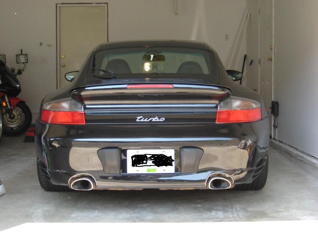

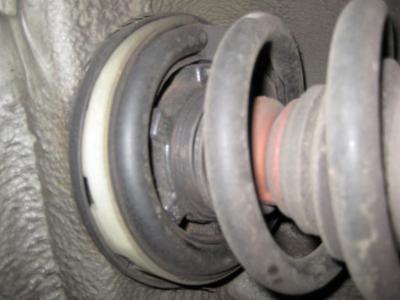

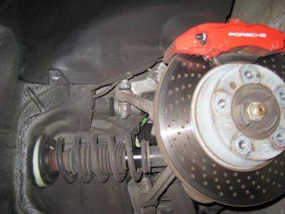

post-27027-1249329162_thumb.jpgpost-27027-1249329145_thumb.jpgpost-27027-1249329124_thumb.jpghere are the pics its kinda hard to see the slant its sitting at, much easier in person as well as the plastic looking toothed ring on the top of the rear springs if this is an adjustable peice or not and if someone has a pic of porsche adjustables they could post to help me know the difference. thanks await your reply.
Those look like factory suspension parts.
Is there a white compensating washer on both side of the same axle? If not then someone has changed things and left a part out.
The other possibility is a bad spring or a totally broken strut.
Best get it checked by a reliable alignment/suspension shop.

i am located up in vancouver canada and yes the white plastic ring are on both the drivers and passangers sides rear shocks. Wouldn't a blown shock/strut be covered in leaked oil? And how would you know if a spring is shot, I didn't even know they could. Also my spoiler isn't moving at all and I get the light if I go to fast or hit the button on the dash. Have you ever heard of one just sticking down from lack off use? Because it doesn't move at all. Thanks Loren and hope you know a good shop up here.

If the shock is broken at the shaft or mounting point there may be no oil - unusual but possible.
