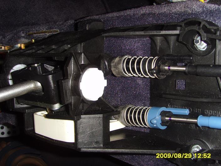

I wanted to thank all those on this forum for all the valuable information. I completed the install of a 997 shifter into my 996 Turbo MY04 :D . I have not driven it after the install, but the stroke of the shifter seems and feels like an improvement. I will try out the my new shifter tomorrow.
Thanks again,
Art (aquinto)

I was able to try out my new (to me) 997 shifter this morning. The 997 shifter shows significant smoothness when thrown into each gear. This was a great upgrade for me. It makes driving much more enjoyable. :D

I was finaly able to install the 997 shifter in my 03 turbo, and I have to say that if somebody is in an doubt about doing this it´s a very easy DIY (I follow the BM instructions) and highly recomended.
The shift gains a complete new feeling of precision and shortness
