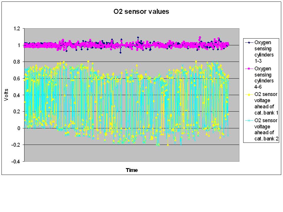

The MAF seems to be working fine. I took a 15 minute drive with the laptop attached and the MAF values varried from 12 kg/h to 150 closely tracking RPM.
The O2 sensor output on the other hand doesn't seem right. Both the pre-catalytic converter ones seem to randomly read between -0.2 and +0.7 volts while the post-catalytic converter ones seem to be stuck around 1 Volt.

I would agree entirely with 199Porsche911. The important thing is that the voltages of the pre-cat sensors are jumping around rapidly, which suggests they are working correctly. In addition to what he suggests, I think it would be worth looking at the voltages of the after cat sensors, to see if one is sluggish, or reading a constant voltage.
The oxygen sensing values aren't in volts. 1.0 is the Lambda value. It should be 1.0 +/-0.05.
Oxygen sensor voltages should be between 0.04v and 0.79v. What are the voltages of the O2 sensors after the cats?
Correct, didn't notice that I was reading Oxygen Sensing. The Durametric tool doesn't give me the post-cat O2 sensor voltages.
Depending on the run, I have recorded pre-cat O2 sensor voltages that range from -0.17V (???) to 0.82V (car warm) and 0V to 0.89V (car cold)
Oxygen sensing value in the same conditions varried from 0.93 to 1.1 (car warm) and 0.94 to 1.2 (car cold)

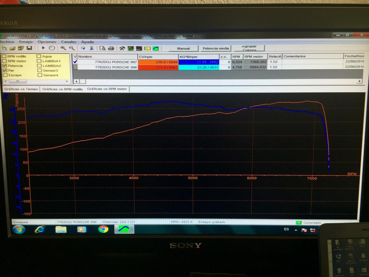

I was to reflash my 996 C2 (MY2000) and first found max power was at 277 hp instead of the expected over 300 (bypass, gt3 throttle body, ipd plenum, bmc air filter...).
Then the guy checking the numbers found too lean mix at higher rpm which I did not expect as car was running perfect IMO, no fault codes nor dashboard lights. Anyhow we postponed the reflash till the lean issue was solved.
See the dyno bellow:
post-103485-0-82137200-1467010616_thumb.
SInce this test last week I've clean the MAF, checked for leakages and read a LOT of posts about it but still could not get a clear idea. Since I have a durametric cable I did a couple tests on 3rd gear WOT a recorded the following parameters:
1-RPM
2-Mass air flow (MAF)
3-Adaption, range 2 (FRA), bank 1
4-Adaption, range 1 (RKAT), bank 1
5-O2 sensor voltage ahead of cat. conv., bank 1
6-Adaption, range 2 (FRA), bank 2
7-Adaption, range 1 (RKAT), bank 2
8-O2 sensor voltage ahead of cat. conv., bank 2
1          2       3      4     5    6    7      8
1.681 160 1,02 -0,19 0,84 1 -0,52 0,87
1.928 188 1,02 -0,19 0,88 1 -0,52 0,88
2.176 221 1,02 -0,19 0,86 1 -0,52 0,87
2.418 237 1,02 -0,19 0,88 1 -0,52 0,88
2.673 244 1 -0,19 0,88 1 -0,52 0,89
2.921 295 1 -0,19 0,88 1 -0,52 0,87
3.156 323 1 -0,19 0,87 1 -0,52 0,86
3.400 342 1 -0,19 0,88 1 -0,52 0,88
3.679 390 1 -0,19 0,87 1 -0,52 0,87
3.985 437 1 -0,19 0,87 1 -0,52 0,88
4.253 468 1 -0,19 0,87 1 -0,52 0,87
4.539 516 1 -0,19 0,87 1 -0,52 0,86
4.816 561 1 -0,19 0,86 1 -0,52 0,86
5.104 589 1 -0,19 0,85 1 -0,52 0,85
5.424 624 1 -0,19 0,84 1 -0,52 0,84
5.697 667 1 -0,19 0,84 1 -0,52 0,83
5.988 695 1 -0,19 0,83 1 -0,52 0,83
6.286 680 1 -0,19 0,81 1 -0,52 0,81
6.565 704 1 -0,19 0,81 1 -0,52 0,76
6.857 764 1 -0,19 0,83 1 -0,52 0,82
7.056 784 1 -0,19 0,85 1 -0,52 0,83
7.306 643 1 -0,19 0,84 1 -0,52 0,81
Any clues?
