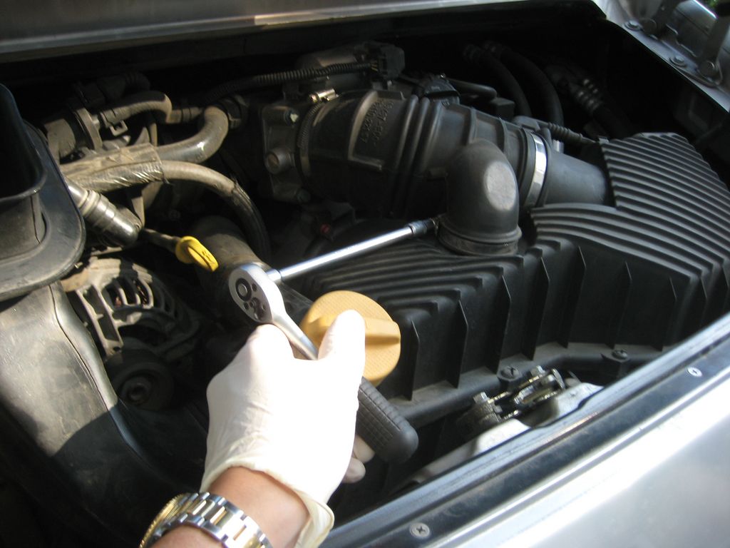

Loose the wraps

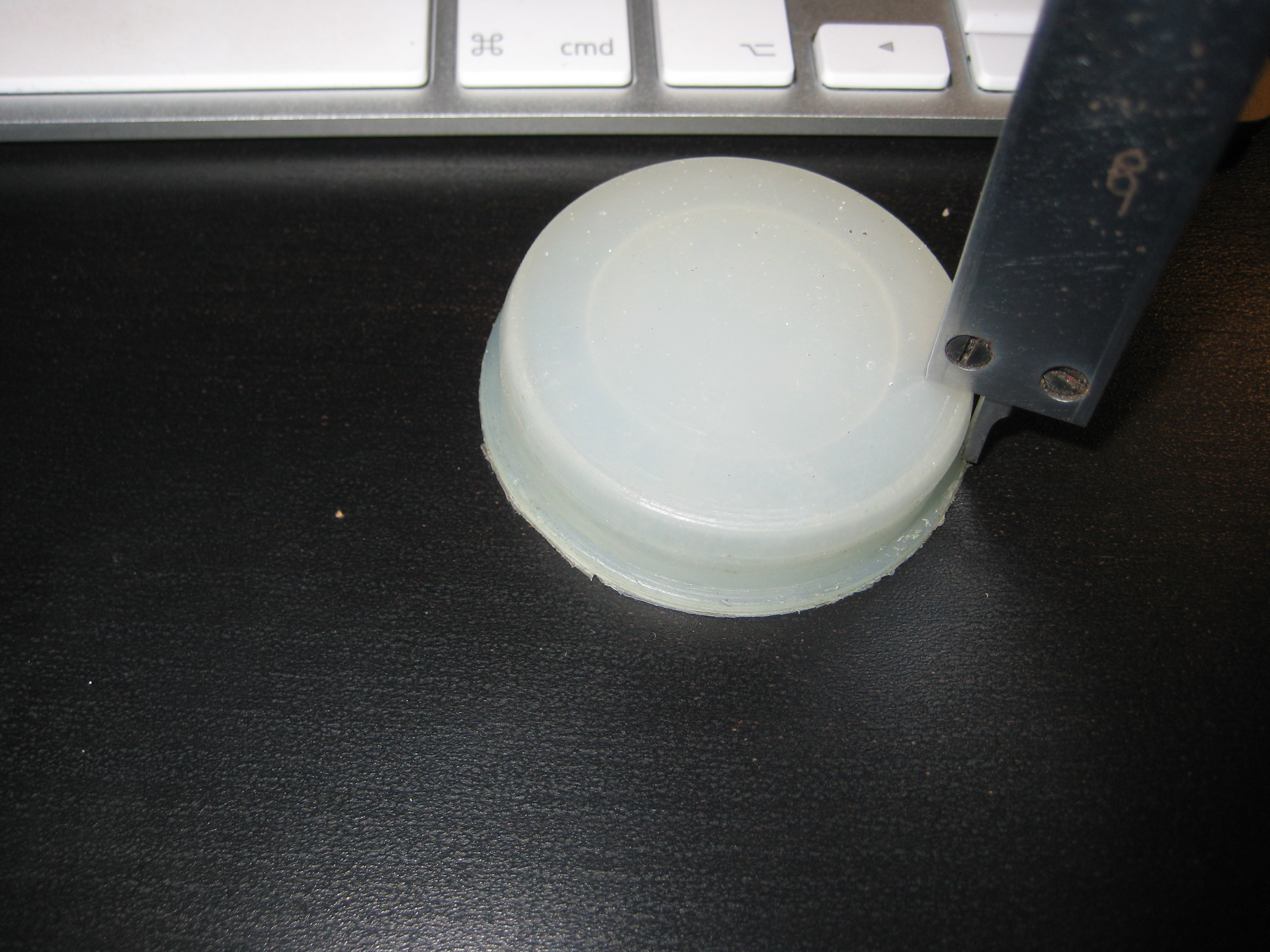

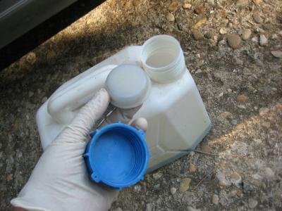

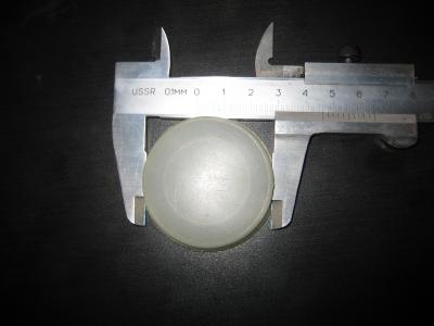

Take a 50 cent plastic tank

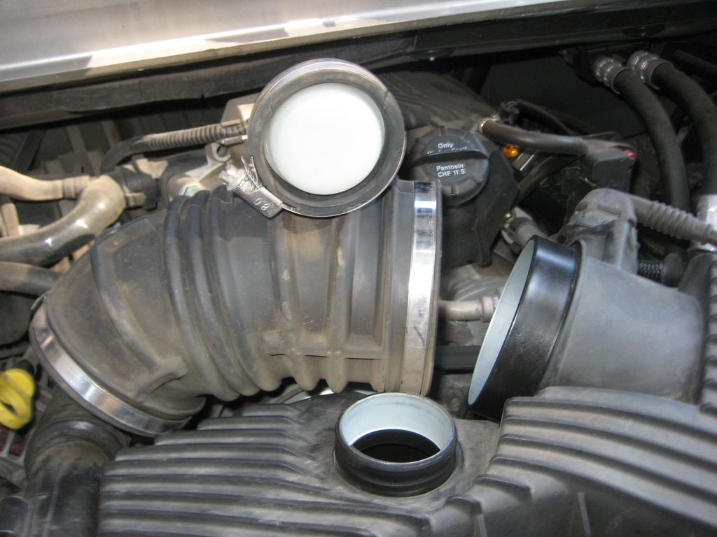

put the middle plastic cap inside the secondary air inlet of the OEM air intake

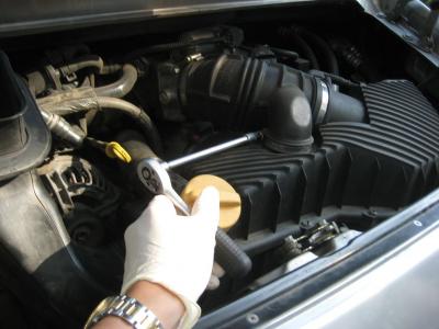

Check if everything is all right and remount the intake with the original wraps
Let the MAF sensor read the new air volume and you are done!
Exactly the same!
How did you find a plug that fit? Trial & error?
Just tried with a couple of tanks...

Sound only really. That opening in the airbox acts like a muffler. All the cap does is disable the muffler. The result is a better sound. More throaty but no kind of performance gains. B)
