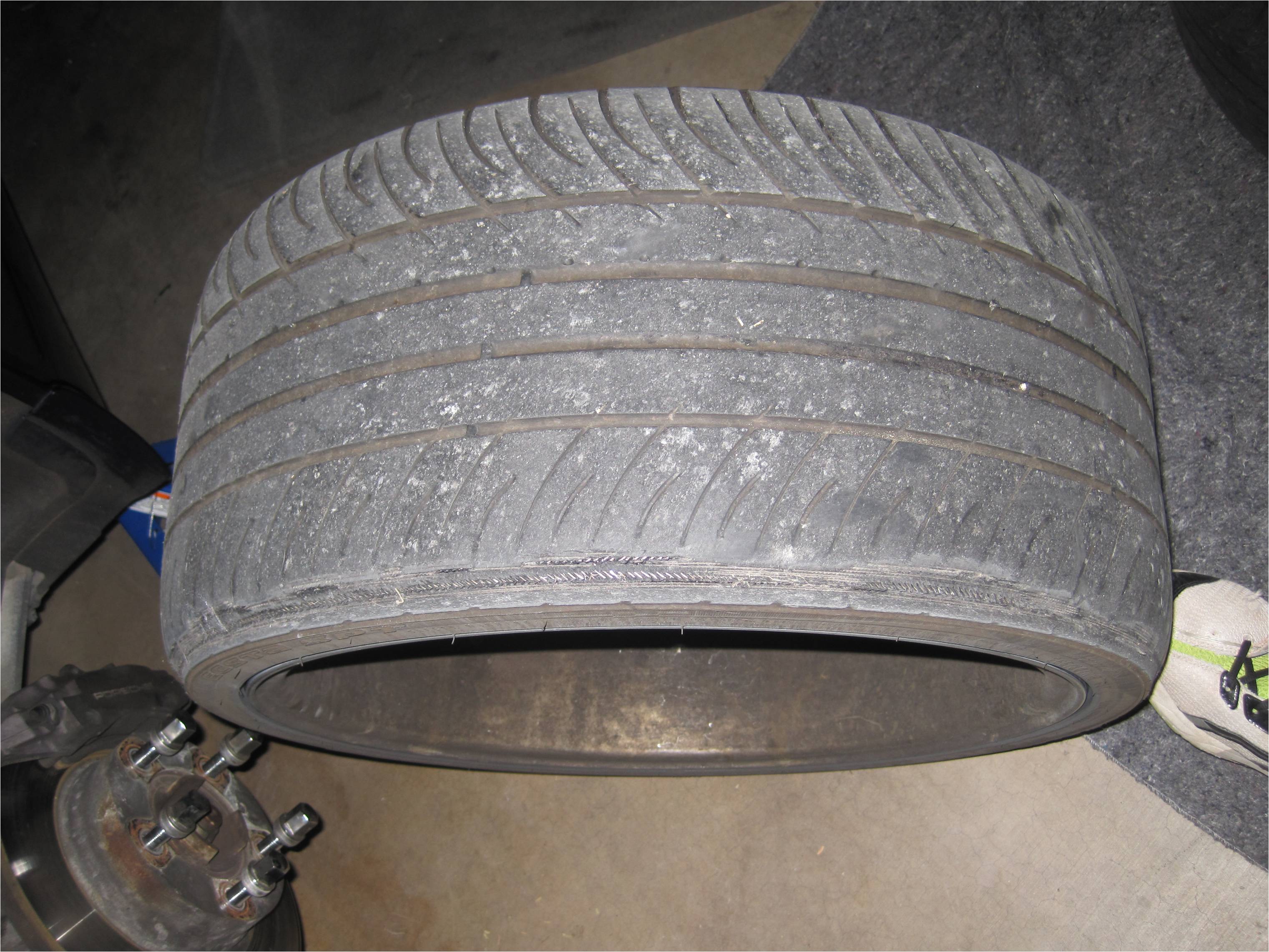

I have a 2000 Porsche boxster which I have recently took the 19" Lobster Claw wheels off of to have powdercoated. The rears had 265/30/ZR19 tires on them.
The car had these wheels on it when I purchased it so it never occurred to me that i might need wheel spacers for these. However when I took the tires off they were worn to the wire on the inside but still fairly healthy on the outside (see pic). Originally I thought it was that the camber? was off angling the wheel inward at the top (I apologize for not using the correct terminology). But another user here on Renntech suggested it looked as thought the tires were rubbing something...??? I looked around the wheel well and didn't see anything that looked like it had been rubbed.

It might be rubbing under spring compression (i.e. bumps and potholes).
Porsche does not recommend 19" wheels on 986 series cars and on the 987 series cars they are 265/35 x19 (not 265/30).

Maybe spacers will help - if it is an offset problem. You did not say the wheel offset.
But if it is a rebound problem then they won't help a tire that is too tall.

I think you need to consder that the suspension noise you've been hearing might actually be these 19" tires hitting something on bumps.

It is an offset problem.
Im running a set of 18x11 on the rear,,,
wasn't rubbing while she is parked, but rubs with more weight in the car + hard cornering.
Ended up installing s set of H&R 7mm spacers.

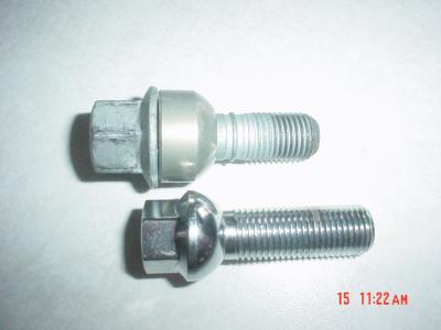

Did you have to buy longer wheel studs??

So I got the 7mm H&R's, I installed them a few days ago along with the longer bolts and I havent noticed any rubbing.
What were your rear tires rubbing against?
