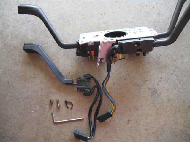

The one in the picture I got from a 996 owner whose turn signal was not working. That OBC stalk will be going into someones car.
