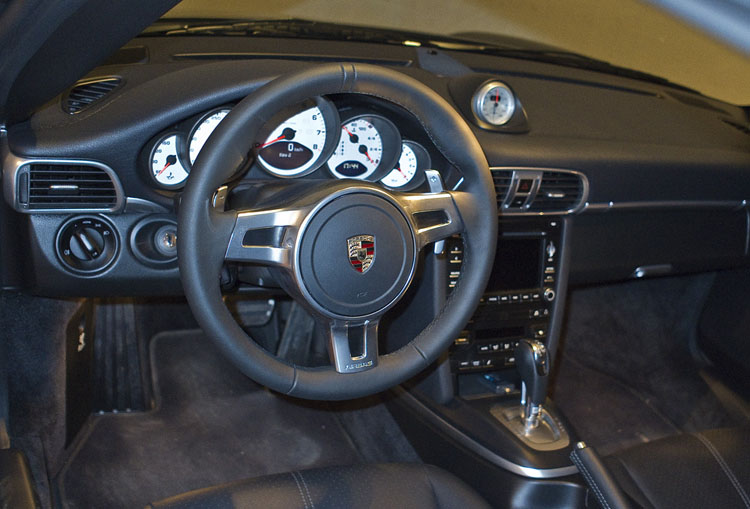

Not a 997 but my dealer told me the new paddle wheel would fit my 09 CS PDK. I have one on order. Could it be that Porsche is using intelligent cross platform sourcing?
I've had it retrofitted last week. It works very well and it is a great improvement most of all because the shape and size of the paddle wheel is more ergonomic than the original.
I paid 970 Euro fitted.
Edited by renos

me too. The new wheel is a big improvement, looks fantastic, is a bit thicker in some places and the paddle operation is smooth.
One thing to know. In '09 PDK cars the retrofit will still work fine except for the little indicators (sport plus, launch control) on the steering wheel which remain inactive..
Mine is a 2009 model (manufactured 12/2008) and the sport and sport plus displays light up (left spoke). I was told that the LC display (right spoke) only works on 2010 cars.
