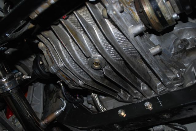

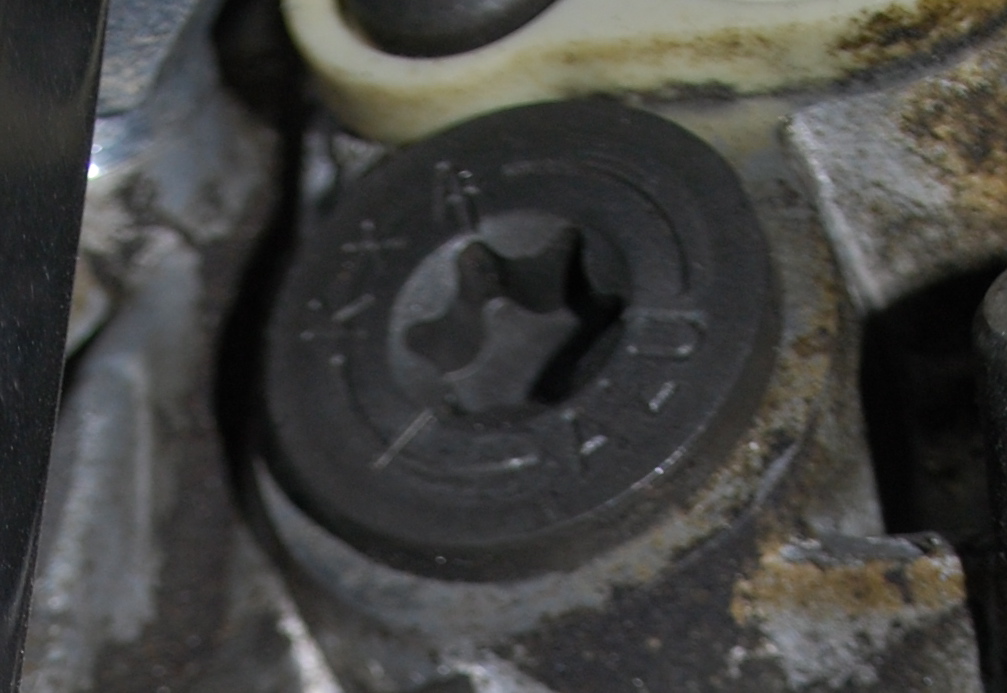

New to the 986 world and while it looks straightforward I want to make sure I have them located properly before I go to task. I have been changing the tranny fluid in my GT3 and 996CAB (as well as many friends 996's) for years and it is very easy but the Boxster tranny looks just a touch different.
Can somebody please point out in the pictures where the two (drain in fill) are as well as type and size? The drain looks like a security bit (not sure why) and the other looks standard.
TIA!
**I assume that these two pictures I just took illustrate the drain and fill plugs but I'd like to be sure before I start going to town on the box :) **
Edited by LVDell
Hard to tell from your pictures but, the drain is a tamper-proof star wrench on the bottom of the transaxle at the lowest point a possible. It requires a special tamper proof star star wrench from Porsche ($$$) or the same from Ebay for about $15
The fill plug is a giant-ish allen-head on the left side of the transe, in front of the axeland, about level with the bottom of the axel. Requires either a large 13-15mm hex head allen head socket. Probably a Porsche special tool, maybe available at an auto, box store or, just purchase an appropriate sized bolt & nuts, tighten them all together but tight and, slip a regular 13mm (or 15 mm socket, whatever) on it, instant "special tool".
The box is supposed to only be filled 11 mm below the fill whole...go figure. Your on your own there.
Good luck, PK
