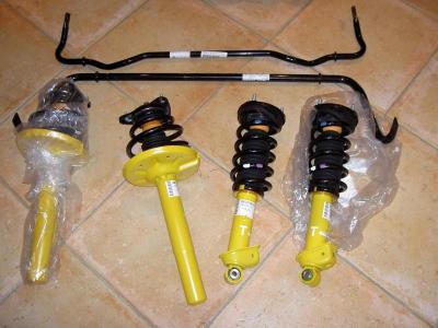

Here is a photo of my X74 suspension components before they were installed. Note the coloured marks on the springs as Loren mentions.
